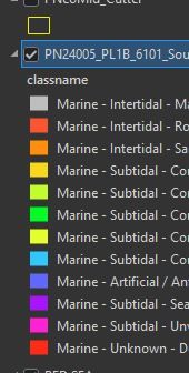

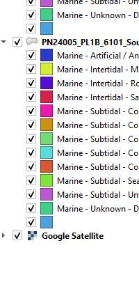

Hi, need help please. How do we achieve the symbology / categories in ArcGIS like the one in QGIS. In QGIS the classes or categories has tick boxes wherein you can turn on and off whereas non in ArcGIS Pro. It woul d be easier to have this kind of facility. See image below: Black background is ArcGIS Pro and white background is QGIS.

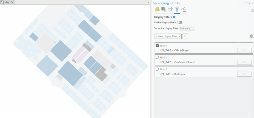

Ah, I get it now.  If neither the Swipe nor Flicker tool are sufficient, maybe Display Filters would work for you?  I may take some time to set up initially, but then you can save the filters and import them later.  They're simple .exp text files containing the SQL query.  It that doesn't work, I'd suggest submitting a detailed post on the Ideas page (after searching for similar ideas first).

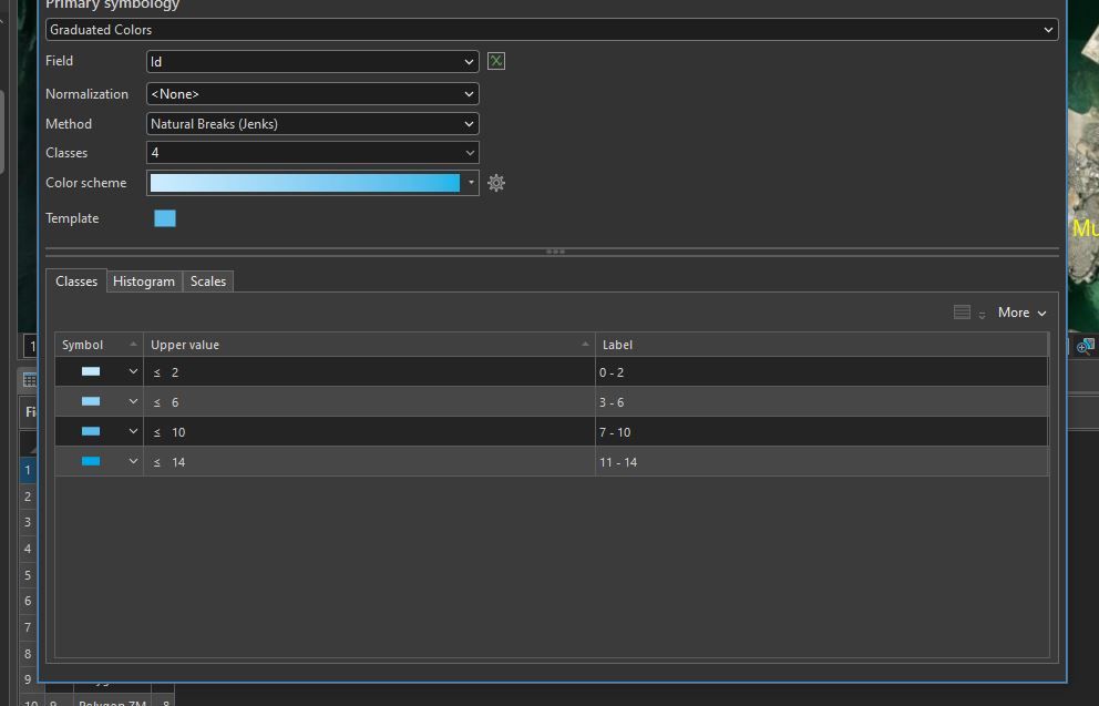

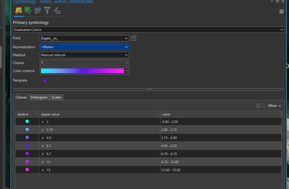

Thanks to this update! It only works on Unique values, though. I hope @ESRI can also make the same functionality with Graduated colors. It would be very hand in presenting for exampling depth data either in Points or in Polygons. See attached images. graduatedpoints.JPGgraduatedpolygon.JPG
