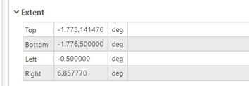

Yes, it used to work with the same data and files I am using right now. However I just noticed something: the extent for the files are different now, some in m and some in degrees:
The shape tessellations (violet) and the shape mapclass (yellow & grey) share the same coordinates. They both should be metric. I do not understand what went wrong, but now one is in degrees. Can I change the units?

You have to use the Define Projection tool.  It looks like they were defined incorrectly based on what you have shown.  Compare the coordinate systems of the files!

Thank you Dan, the function run successfully now.
