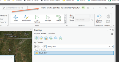

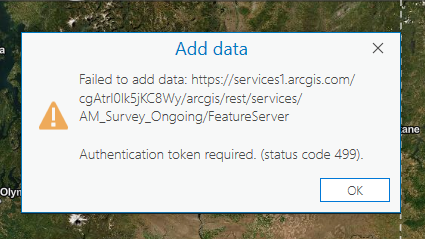

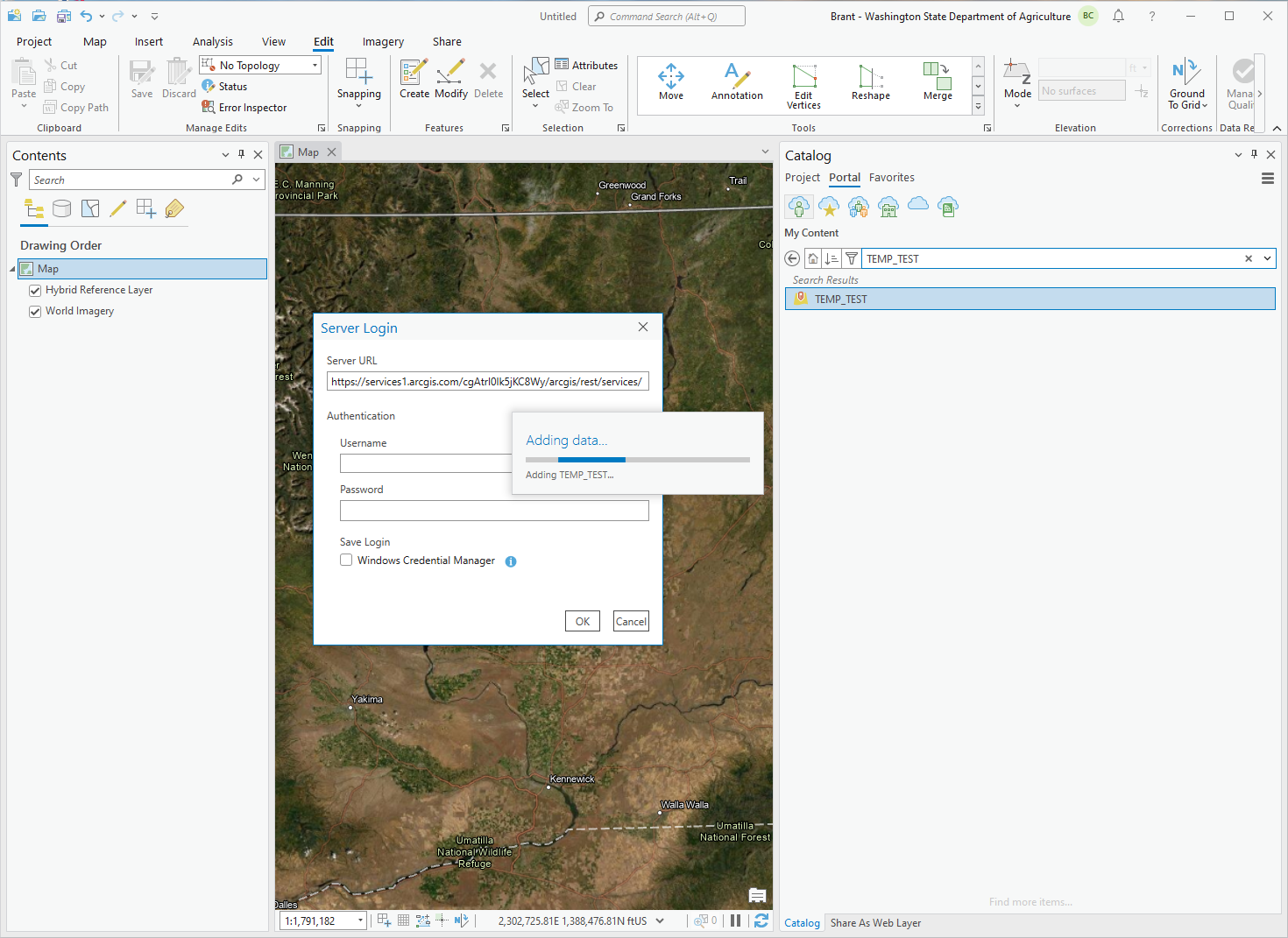

I opened up Arc Pro this morning and attempted to add a hosted feature layer from my AGOL content, and was presented with Server Login prompt.  I tried entering my AGOL credentials, and received an authentication error.  Tried with numerous other feature layers, all of which I am the owner.  I was even able to successfully publish a new layer, and get the same error when trying to add it to a map in Pro after publishing.  I am only able to add layers that are shared publicly (everyone).  Sharing to owner, organization, groups, etc. gives me the error message.  Access from web maps in AGOL is working as expected.
The weird thing is that I've got another machine with the same version of ArcPro, and everything works fine on that machine (logged into the same AGOL account).  I can add layers to ArcPro as expected.
This issue is brand new, and everything was working fine last week.  I updated to ArcPro 3.0 on both machines about a week ago, but no issues until today.

I found a solution to this problem that worked for my team (reinstalling, rolling back to 2.9, and clearing the cache all did not help). When I encounter the server log in screen, I simply open my browser, log into AGOL, and then close and reopen Pro. That seems to flush the authentication and everything works fine again (though it does still happen from time to time). Hope this helps!
