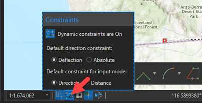

hi@ABishop
They are called Dynamic Constraints and you can turn them off with this button:

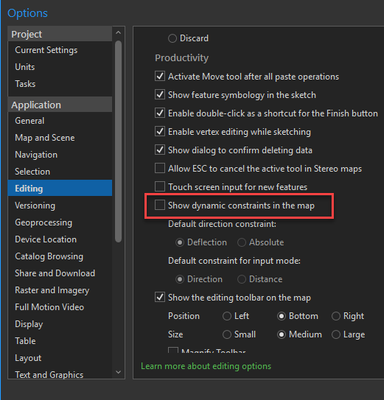

.... or from within Editing options:

hi@ABishop

Turn OFF Dynamic Constraints using the button on the screenshot.
