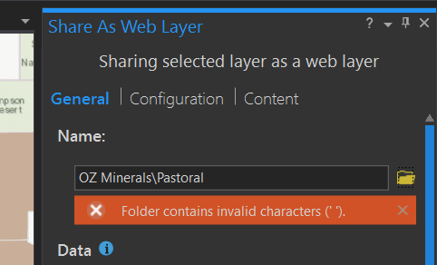

In Portal for ArcGIS you are allowed to create folders with spaces
But if I try to publish a layer to any of these directories with space I get an error informing me that the folder contains invalid characters?
The annoying thing is that I can publish it to a folder that does not contain spaces and then move it with Portal but can't do it from ArcGIS Pro!
Am I missing something?

There is a bug on this, the workaround is to (re)publish to root, then move the item to the folder, same problem with AGOL, but I don't see this being fixed, developers hate spaces, so do I, but they're what I inherited....., with that said, Arc can (re)publish to folders with spaces, so.....equivalency issue?
DeanHowell1
Thanks Thomas, that is exactly what I have been doing and that makes it even more frustrating as ArcGIS Pro and Portal are fine with having spaces in folders except when publishing to it.

Thomas Colson‌ is correct.  [BUG-000100645: The error message "folder contains invalid characters" is returned when a web layer is published to the Arcgis Online folder, which contains a space between words or a '/'.] is marked as In Product Plan.  For others who are experiencing this issue, if you would like to be attached to the bug, contact technical support.
