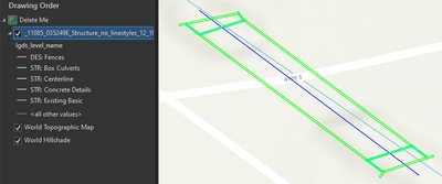

Thanks for writing that and responding. This method works on a manual basis where I have to go and assign each color. But not sure that is sustainable for a large dataset. Plus, my symbology in the TOC is not updating which makes me think it might not publish correctly in AGOL. In this screenshot:
The centerline line is blue as it should be ("rgb(0,0,255)"). But in the TOC the centerline is the default light blue assigned in the original random symbology. The same goes for the outer green lines - rgb(0,255,0). They show as a light green (box culverts) in the TOC.
Each line type I have has a red, green, and blue value. I was hoping to do an arcade expression to create the "rgb(red,green,blue)" value and apply to all my features at one time. Is that not possible (to where it will reflect in the TOC in order for me to publish correctly to AGOL)?
(removed screenshot since it would not let me post. It is attached as an image)

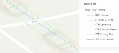

I did use my rgb values and assigned them as symbology (using Arcade with the expression of:
"rgb(" + Text($feature.igds_color_red) + "," + Text($feature.igds_color_green) + "," + Text($feature.igds_color_blue) + ")"
But, like we have seen before, it just changes the symbology on the map itself and not in the TOC (this is 2.7). When I published that to AGOL, it did not take my new symbol colors.

AGOL view:
I suppose that I will have to manually change the colors of all my line types!
