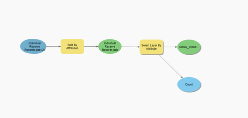

Hi,
I have built the model in the picture, which works fine. But the next step I want to do is for each of the new feature classes that are created, I want only the most recent record of each unique record from the species field. But I want all the associated fields to come through into the new feature class. See table picture below, for example I only want the most recent record of Sparrowhawk.
I am not sure how to do this and if I can add it into the model as part of the process?
Thanks

First off you would need your "Date" field to be of type Date. Nothing programmatic is going to be able to analyse that currently with variants of free text, date formats and ranges. I would suggest using year (if the field was numeric) but I note some duplicates in that case. Once you have a nicely formatted date field then life would be simpler with python, but via model builder, off the top of my head...
Add a split by attributes, use "Species" field to split them and give you one feature class per species. Run a "Select by attributes" on each using:
Date = (SELECT MAX(Date) FROM <insertfeatureclassnamehere>)
Then merge each of the selections back into a single feature class

Thanks for this @RichardHowe. I had a go with the model below, and ended up with the species all split out into feature classes, but then am unsure how to get them all back through the select by attribute process and then merge back. Do you have any other tips? Sorry I am new to model builder and python.
Also is there way for the process to cycle through the FGDB and do it for all? I could get a iterator to work and then input to the split by attributes.

It's be a while since I used model builder tbf. If memory serves you can only have one iterator per model. So you would need to save that model and then embed it in a new one which will allow you to add another iterator which you could use with the "Make feature Layer" tool which you include the aofrementioned query with (giving you one feature per feature class), then use all those feature layers as inputs for the merge tool.

Because the output feature classes from the split by attributes tool come from an iterator you can't just connect them to the merge tool (which I think you understand from your previous reply).
I think the recommended way is described here https://community.esri.com/t5/arcgis-pro-questions/merge-outputs-of-an-iterator-modelbuilder/td-p/11... by using the Collect Values tool https://pro.arcgis.com/en/pro-app/latest/tool-reference/modelbuilder-toolbox/collect-values.htm to collect the paths of the output feature classes.  You would then use the collected values as input to the merge.  Obviously before you do the merge you'd want to Select By Attributes on the MAX(Date) as Richard demonstrated.
RichardHowe
Ah yeah, good call. I had forgotten about the collect values option (as I said a while since I ever used MB). I think this should work fine.
If not though, my suggestion was to save what you have @SteveMasters and then create a second blank model. You will then be able to drag and drop your saved model into that blank model (just like any other tool) and then re-use iterator.
