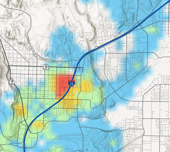

I think this may be a bug but I am not sure. I have a simple IDW raster that I created from some point values. It is symbolized based on a manual classification method of five color classes. On my map, the image looks nice and is sort of blended:

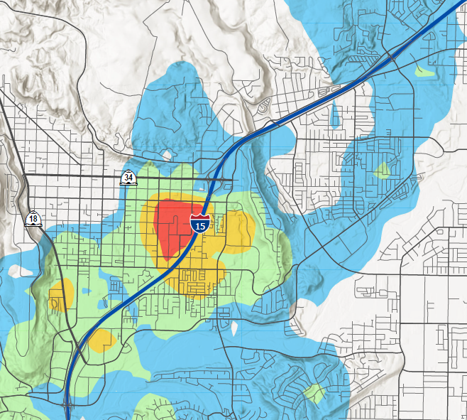

But when I export this layout to any file type (PDF, PNG, JPG, SVG, EMF, etc.), the image gets "dumbed down" to be really basic and standard:

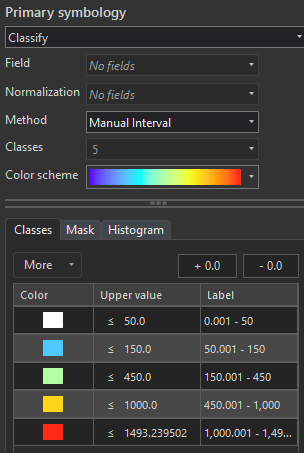

This is what my classification scheme looks like:

All my exports look like the cubic resampling.
Sadly, this is a bug in ArcGIS Pro that hasn't been fixed in 4+ years (I reported it to ESRI in 2018). The Bilinear method doesn't display the raster imagery correctly on the screen, but it does print correctly as you discovered.
ArcMap displayed the data correctly, ArcGIS Pro doesn't display it on the screen correctly. Since it's been around for a while, I suspect it's something fundamental with how the software works.
