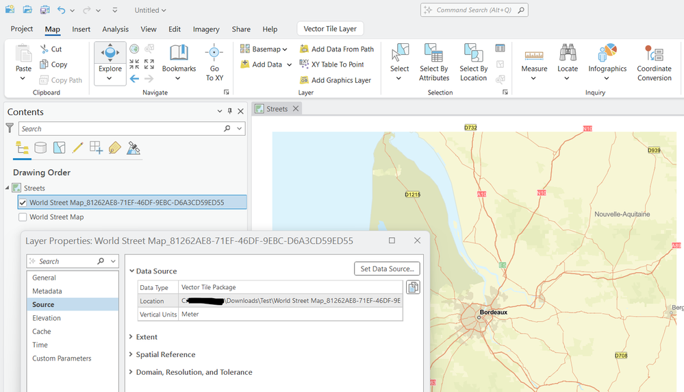

@cweir, unfortunately, I can't reproduce your issue. Following your suggestion, I changed the ArcGIS Pro settings to now be able to choose a custom directory before the map download (thanks for the tip).
I have chosen the 'Downloads' folder and I have been able to export my World Street Map basemap area of choice; see below.
The full export file name is World Street Map_81262AE8-71EF-46DF-9EBC-D6A3CD59ED55.vtpk, mentioning it since my previous image doesn't show the complete name with file extension.
