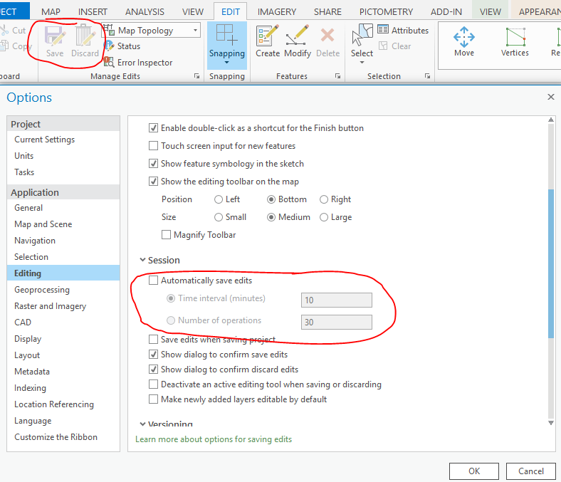

"Automatically save edits" is disabled, but so are the 'Save' and 'Discard' button. And my edits are being saved
18595
26
05-01-2017 09:46 AM
AZendel
Am I missing something? I personally don't like the idea of edits being saved without me deliberately saving or discarding them.  What if I accidentally select 1000 features and hit the delete key when I only intend to delete one feature?  As you can see below, I've unchecked "Automatically save edits", but the 'Save' and 'Discard' buttons are disabled, so I can't use them.  If I close Pro and reopen it, my edits have persisted even though I never clicked save.  As you can see, I've also checked "Show dialog to confirm save/discard edits".  In this particular case, I was editing points features in an unversioned feature class stored in a SQL Express "Personal SDE" database.
It's been a while and I can't remember what these settings were 'out of the box'.  I think that "automatically save edits" and "Make newly added layers editable by default" so both be disabled when someone starts using pro for the first time.  I believe the latter is enabled by default. If so, that is very dangerous. I think every edit session should be very deliberate, especially when editing 'enterprise' data.

So recently I have noticed that my Edits in a Versioned SDE GDB are saving automatically.  This has never happened before.  Previously I have always had to hit the "Save" button to save my edits, but now they magically are saving automatically.  Here are my Editing settings, which to me are still set the same as before.  Did the latest update change something??  I am at the latest version, 2.4.2.
DavidWheelock2
See the thread above and the comment by Kory Kramer on 10/11/19.
https://community.esri.com/message/886946-re-automatically-save-edits-is-disabled-but-so-are-the-sav...
Those settings only apply to versioned data.  Edits to unversioned data are saved automatically in Pro.  This issue goes back to 2017.  In ArcMap you could cancel an edit session and discard your edits.  Kory indicates above that a resolution is in the works but it may take a while.
