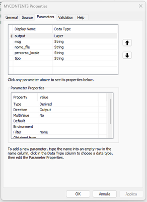

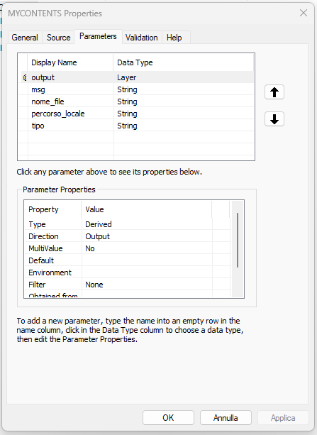

In ArcMap, the script published as a geoprocessing service works well, with these properties:

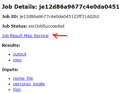

In fact, the Output Layer Parameter is clearly visible in the resulting MapService.

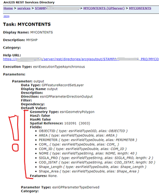

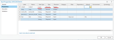

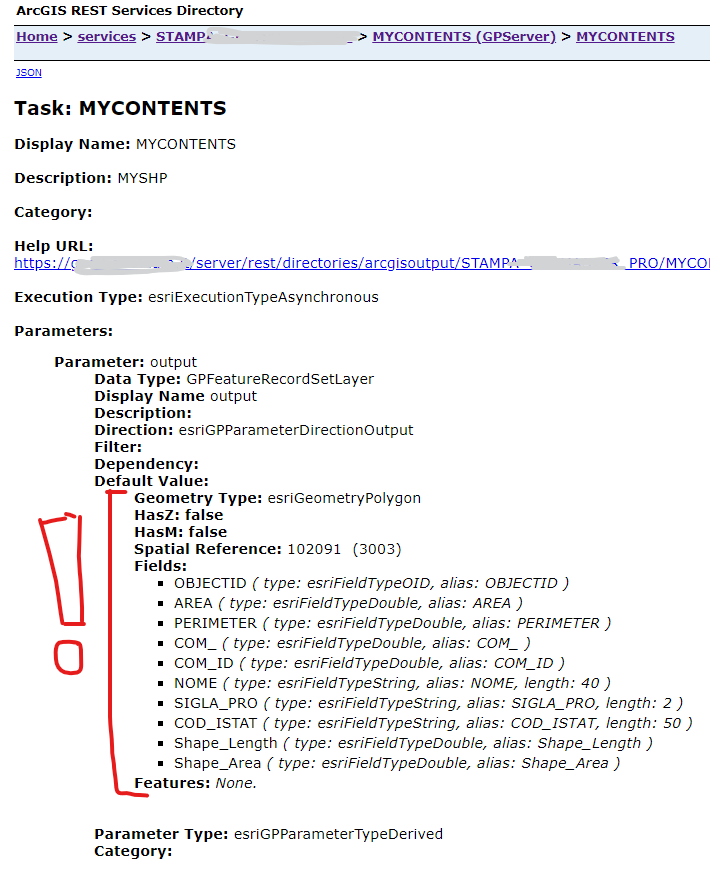

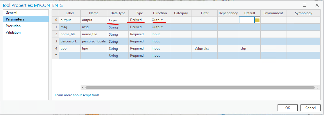

The same script published with ArcGIS Pro with these parameters
results in these output parameters in the geoprocessing service.
This is a problem because it forces the output to have the exact schema of the shapefile used in the publishing process.

Why ArcGIS Pro do this?
Have you a solution?

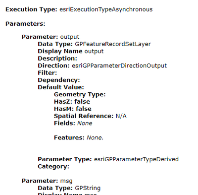

Hi,

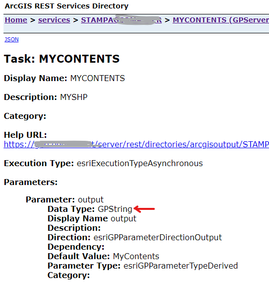

I've partially resolved removing the layer added to a current map by scrypt, before pubblishing.
This produce output parameter without default schema:

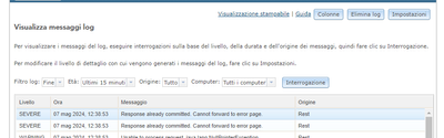

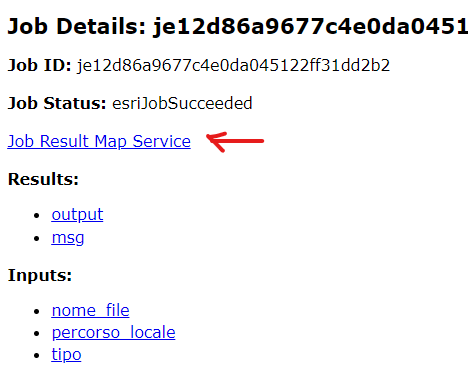

But: layer in Mapservice don't have Query Capabilities...
this cause that is not possible to open attribute table in Map viewer and manager logs this error
Have you an idea?
