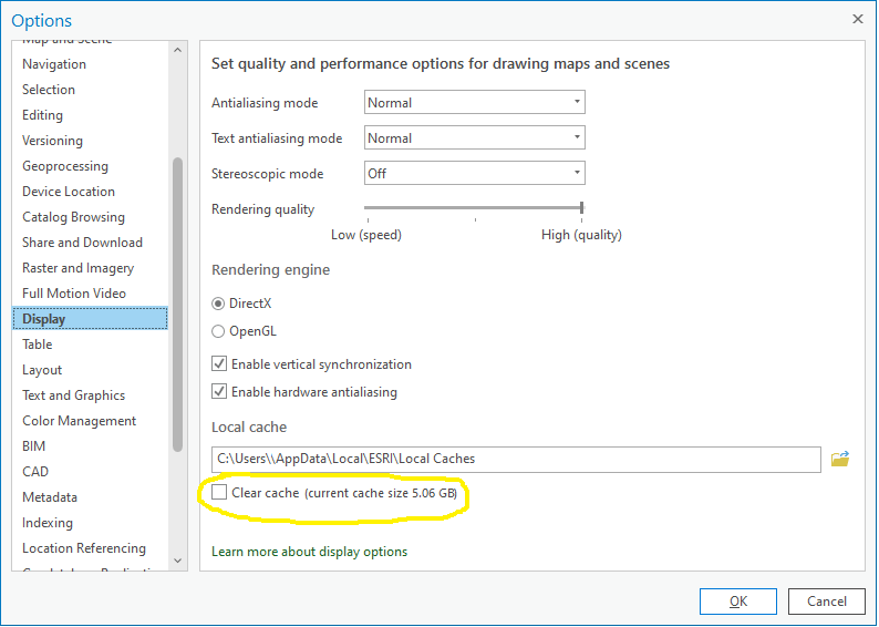

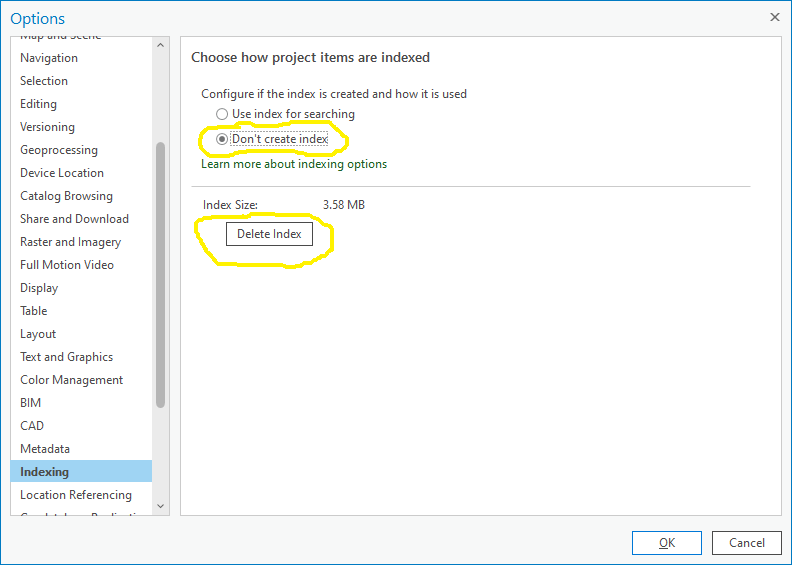

Double check that you cleared your Display Cache and have Indexing turned off:
TimJohnston5

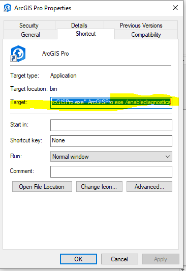

Have you tried generating a Diagnostics Log?
From the command line, or a shortcut path, add the /enablediagnostics to the end of the target path.  This will generate a log file which you, or ESRI support, can review to troubleshoot the issue.  Once ArcPro is started, then log file will be written to:
C:\Users\[YOUR USERID]\Documents\ArcGIS\Diagnostics\ArcGISProLog.xml
