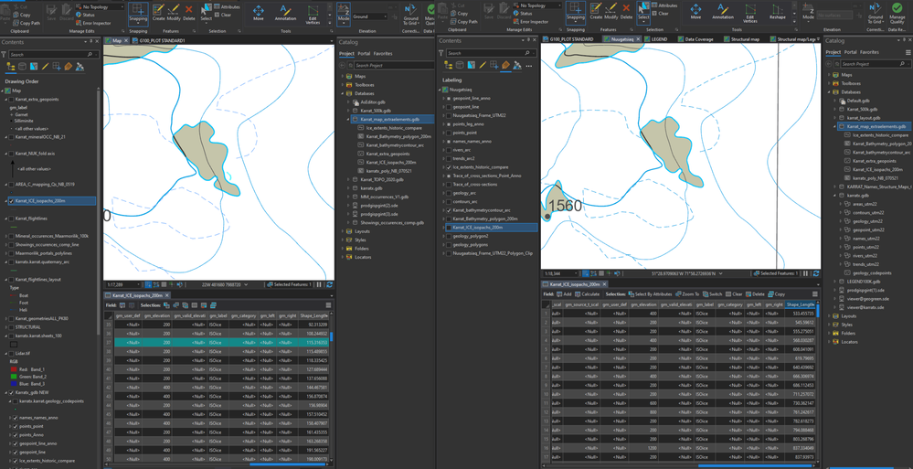

I am using strictly ArcGISPro. i have numerous projects, and often have 2 open simultaneously - one for the layout of the map i am currently working on and one for my 'working' regional project.
if i make an edit to data in a .gdb (located on a network server) in one project, this is not seen in the other project. even if i refresh the .gbd in the folder tree, save, close and reopen the project, whatever.
 here is a screenshot where you can see 2 projects side by side. they both have the same feature class (Karrat_ice_isopachs_200m) open from the same .gdb. edits were made to remove features smaller than 500m in the project on the right. this was saved, the project closed, reopened. the folder trees refreshed etc ect. but as you can see the project on the left still has features below 500m in the database!!!! how can this be?
what is the point of this? we tried using enterprise geodatabases but it was even worse. how is anyone supposed to have an efficient workflow if edits are not applied or visable anywhere else?
this is insane.
