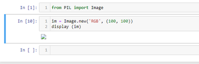

When running a little test notebook with ArcGIS 3.0.3, I am able to display images without issue.
After updating the software to ArcGIS Pro 3.1.0 and running the exact same notebook, I get the following result:

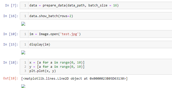

Here are some other examples of failure to display content in an ArcGIS 3.1 notebook:
What could be causing this issue? Again, ArcGIS Pro 3.0.3 works perfectly fine, and updating to 3.1 breaks it.

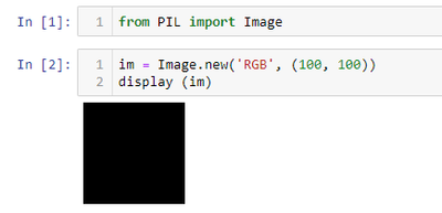

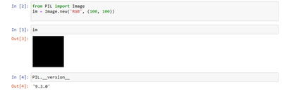

I tried both in Pro and from standalone notebooks and it looked like it worked OK on my end:
If you're trying this from Pro, could you see if it works from standalone notebooks? Could you also try using the default arcgispro-py3 environment to isolate if it is environment specific?
Thanks!
