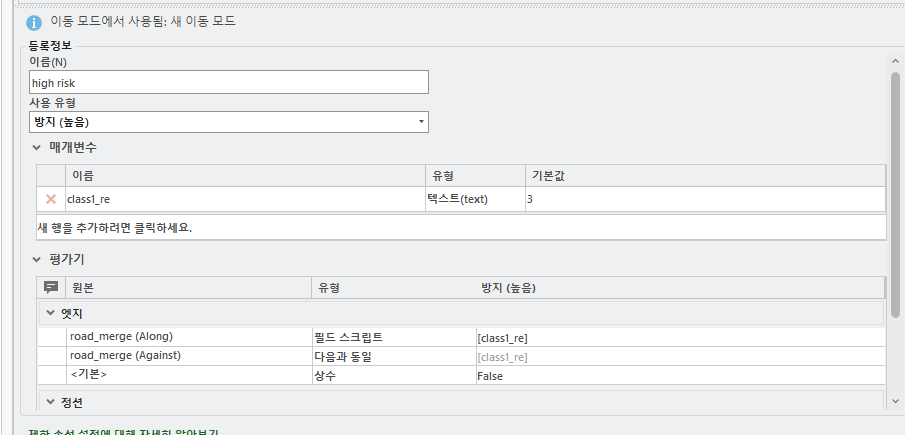

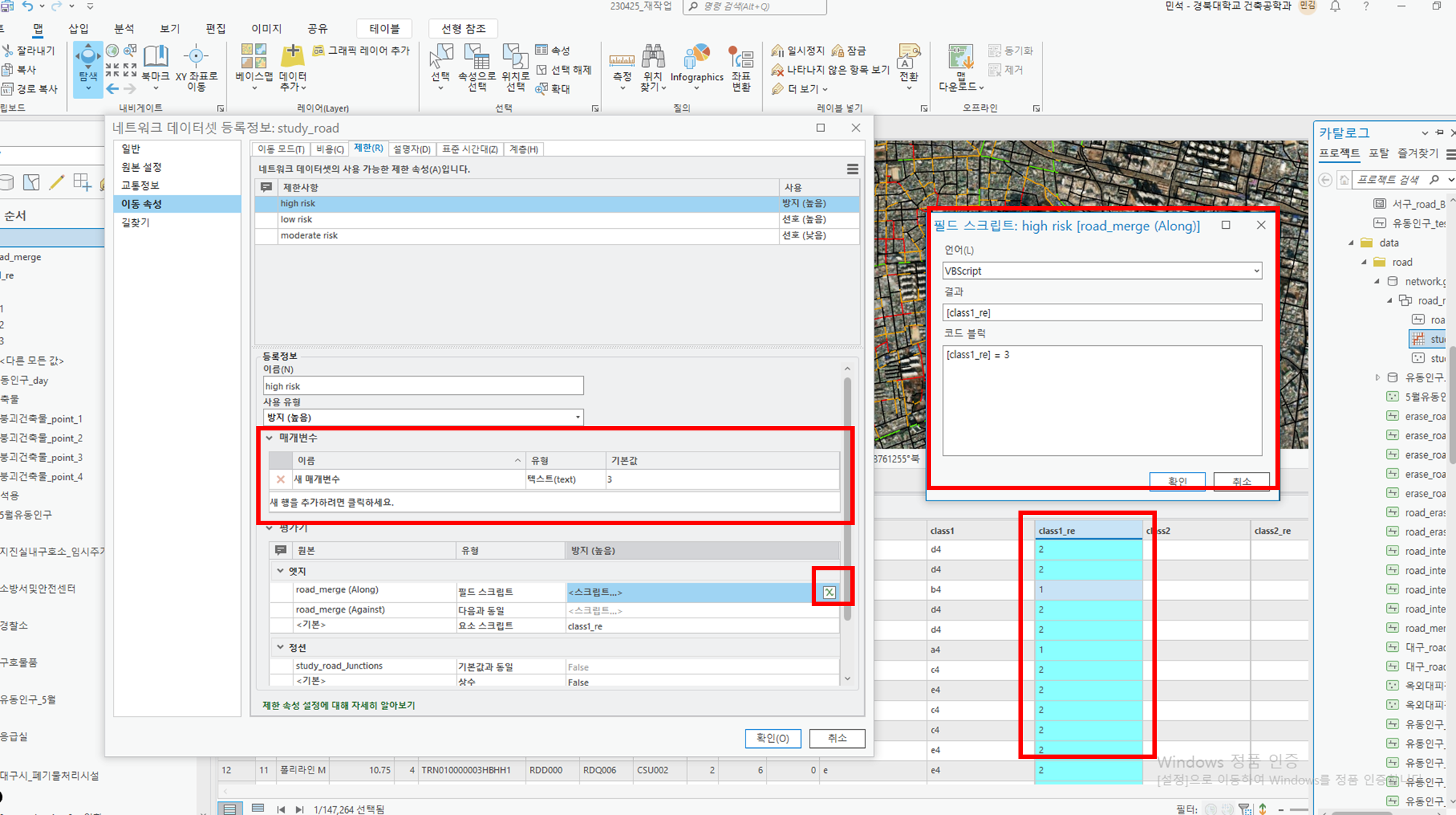

[class1_re] is a text syntax, and I want to classify and use it as follows using attribute values.
The value of "1" is prefer (high), and I want to use this road with low risk in my research.
"2"is an avoid (low), moderate risk less preferred road than 1 and better than 3.
"3" is avoid (high), and it is set as high risk. I want to avoid this road as much as possible.
I want to set Parameters and Evaluator .
As shown in the figure below, in case of avoid(high), should [class1_re] = 3 be set in the field script of evluator?
Or do I need to modify the value of the parameter?

1113
It's not exact, but I set the name of the parameter to the field value, the type to text to fit the field, and I entered the default value of 3, which is the value I set as high risk.
In the case of the evaluator, it is not clear, but it is set as a field name such as edge or junction.
As a result of the analysis, high risk (setting: avoid (high)) was bypassed, and low risk (prefer (high) was analyzed.
If I've misunderstood, please tell me, I'd really appreciate it.
