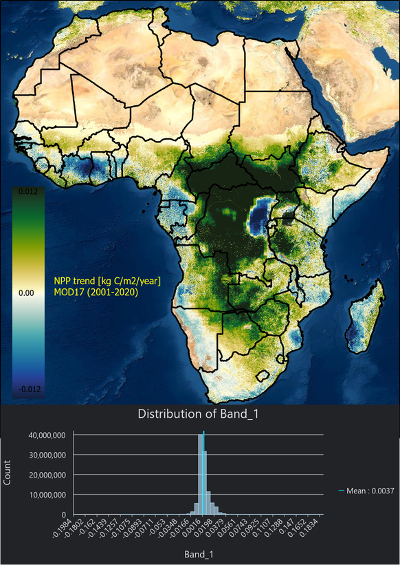

Solved using "trend" in CDO (https://code.mpimet.mpg.de/projects/cdo). Gives reasonable value in line with "manual" calculations. Even if multidimensional tools are nice and very computational effective (which CDO is as well) I find it tricky to keep track of time settings etc. And why can't TREND take normal multiband rasters files as input? The ARCMAP tool Curvefit (https://www.umesc.usgs.gov/management/dss/curve_fit.html) is excellent but slow for big data sets, the data set below ( SUBDATASET_1_DESC=[20x19070x18091] Npp_500m (16-bit integer) ) took a about 3 minutes to calculate the trend (gain, offset) with either CDO  "Trend" or ARCGIS Pro "Multidimensional Trend", using the *.nc file as direct input. Interesting pattern in east Congo?
