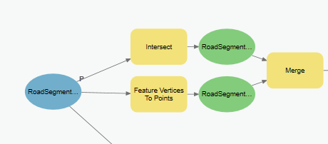

Is it possible to explode the features of a multipoint feature class into a point feature class using modelbuilder? Or is there a better way for me to create a point layer that stores the start, end and all intersection locations of a roads feature class?

What is wrong with Feature Vertices to Points?

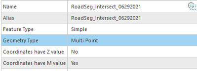

Feature to Vertices isn't the problem. Using Intersect and changing the output type to point left me with a multipoint feature class. I get an error when I try to merge that with a point feature class.
