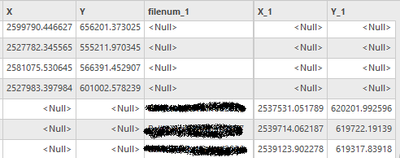

I'm aware of the "join field" tool and I'm using it as a work around for now. When you're just transferring values from one field from a joined table to the feature class, it only requires one step and therefore it's actually easier. But not necessarily if you're trying to repopulated a field that's already in the 'target' feature class or table.  And it's not easier when you're doing arithmetic across both tables such as (featureclass.field1 + jointable.fieldX) * jointable.fieldY. It's also not faster in my current need: I have a stand alone table that I need to populate with X, Y coordinates from several 2 feature classes, meaning I have to do 2 joins. And this is what I get when I do that with the Join Field tool:
So now I have to
1) Select by Attributes where X is Null
2) Calculate Field twice, one to transfer X_1 to X field, one to transfer the Y_1 to the Y field
3) Delete the unneeded X_1 and Y_1 fields.
