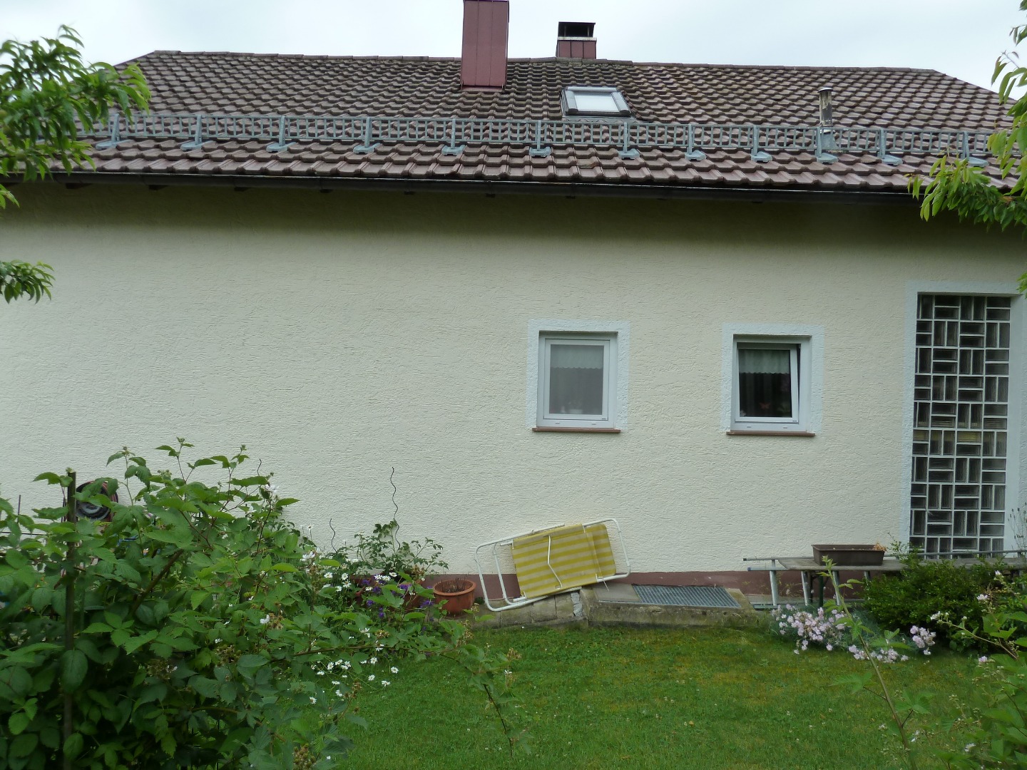

inital situation: I have a 3D-Modell of buidlings and want to match the facades of the buildings with pictures i've taken of them. These pictures are not taken orthogonal, so i have used the "Crop-Image" function in City-Engine to rectify them.T
Up to here, everything is working fine.

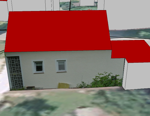

Now i change again to ArcGIS Pro to the "Multipatch-Texture"- Tool. But when I want to match the facade with the croped image, the displayed image on the Facade is showed mirrored.
Orginal image:
Mirrored image on facade:

With the existing editing functions it's only possible to zoom, rotate or swivel the image, to match it correctly with the fasacdes.
Any Ideas why the image appears mirrored? Any advice?

This is Image of the facade after editing it with "Crop Image" in City engine...

I checked this now. The "Built-In-Face-Culling" was activated. I turned it now to "None", but the error appears as before...
Also I've tried it  now with the same facade-image on different 3d-models. The error appears again.
In general i can say:
I've tried different facade-images on different 3D-Modells.
Seems to depend on the choosen image. The facade-images, wich appear mirrored on a particular 3d-model, also appear mirrored on different 3D-Models
