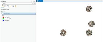

Is there a way, to merge the tpk files of different locations in single tpk file, such that the final result will have all the merged tpk files. I am looking for something in the below image.
RaghavGupta
Instead of creating TPK files of different regions we can create a single tpk file.

Please see below image for reference.

It doesn't look like it, you would have to use the inputs used to create both tpk files to generate a new one
