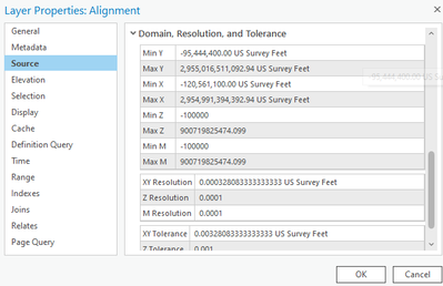

That will only work with routes that are "m enabled".  To start, you should check if your poly line feature class is m enabled by going to the properties > Source > Domain, Resolution, Tolerance.  If it lists an m resolution, you are good.

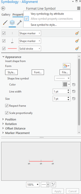

Once you have created the route feature class, you can then go to the route's symbology, click the three lines in the top right and select "Allow symbol property connections".
Once you do that, you will be able to select "at measured units" for your marker layer.
