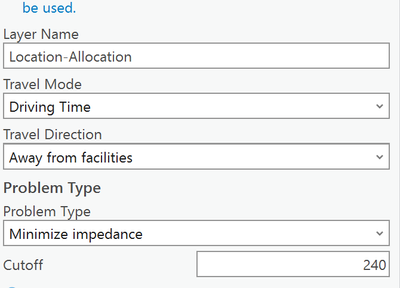

Dale_Honeycutt
Just curious, but for the Make Location-Allocation Analysis Layer, doesn't specifying a Travel Mode that uses  time (minutes) instead of distance work for you?  You'd specify a cutoff of 240 minutes for the Cutoff and each facility would cover the 4 hour distance, whether it be 80/100/120 miles.
