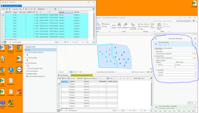

I create some quick sample data.  Initially I created 2 test feature classes, one containing 20 "Species" points (I named it Test1PointData) that fall with 2 test polygons (Test1PolyData).  The unique ID of the polygons is names PolyUID and the "Species" attribute of the points file contains the species name.
First I ran a spatial join using the points as the target to add the Unique ID of the polygon they fell within to each point.  Then I ran the Summary Statistics tool on the resulting spatially joined points file (the resulting FC being named "Test1PointData_SpatialJoin" in this example).
The image below shows the results and the options I used in the Summary Statistics tool.  The light blue highlighted records in the upper left are "Test1PointData_SpatialJoin" points that fall within the Test1PolyData polygon having UID "Polygon1".  It is just here to illustrate that the returned statistics are correct.  Hope this helps.
