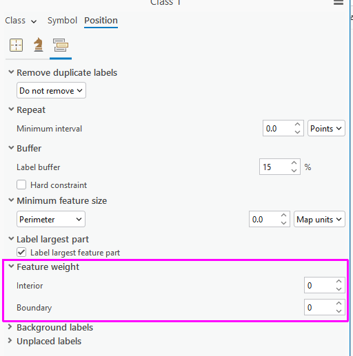

Something else I thought of - do any of the other layers in the map perhaps have a feature weight set so labels will try to avoid them?
isaacosmond
My feature weight is set to 0 for all lines within the file, and there are currently no other layers active in the project.
