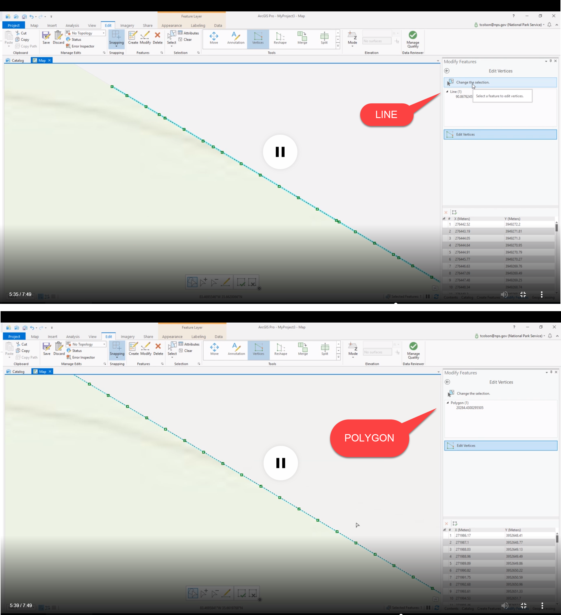

ThomasColson
MVP Alum
Ah....but I can repro on the curve-of-many-vertices. Kory Kramer‌, the way I did this, was, make a polygon using the Freehand tool, densified it, then created a line using trace. The vertices are clearly not the same as the polygon vertices.

You can see in the video I get both behaviors: Once I get different vertices than the polygon, then I get the same one. Bear in mind my test geometry is pretty simple, based on the OP description, they have some pretty complex lines and arcs. Also note the performance issue I see during the second trace, the trace lags well behind my mouse pointer and stops for a while.

Thanks for the video! From what I can tell in the video, you are actually getting more vertices when you trace (creating a line). However, I'm not seeing any visible difference between the features.
I'll look into it more though. We can also wait for Kelly to reply and answer some of the outstanding questions here.
