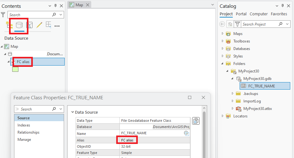

I see what you mean. The Source tab doesn't show the FC name either, just the FC alias. And there's no tooltip when I hover the mouse over the FC; I might have expected the FC name to be displayed in a tooltip.
