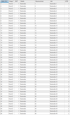

Good evening,
I'm searching for help regarding field calculations. 
I have a column called NVT which divides the total amount of points into groups.
The query shall divide the points having the same NVT number into groups of 32.
The division into subgroups of 32 is consistant. the amount of points per NVT isnt
For Example: NVT 1= 96 points --> NVT 1 shall become 3 subgroups.
NVT1:
Points 1-32 get LFD3 =1
Points 33-64 get LFD3 = 2
Points 65-96 get LFD3 = 3
Same for NVT2 and NVT 3 and so on.
Thanks in advance 🙂 Hopefully my explanation is okay!

FynnScharpen
Thats the problem. NVT can have numbers between 1 and 100, has to be sorted and its frequency of each varies. Hausnummer is only sequential in this test case normally it isn't.
Not sure if you understood my problem. My technical English needs to improve.
1. Step: Sorting all addresses based on NVT
2. Step: Count the number of addresses that have the same NVT number.
3. Step: The first 32 addresses with the same NVT number get a 1 in LF3D if there are more than 32 the next 32 get the 2 in LF3D and so on.
4. Step: Repeating step 3 for the next NVT number

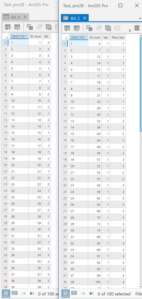

Like this?
Left table... Vals_ range from 1 to 3 inclusive.
Purpose : sort, group and reclass the Vals_ data into groups of 12, sequencing each group from 1 onward.
Example:  there are  1: 38, 2: 31, 3: 31]
Groups are split at
1: [ 12, 24, 36])
2: [ 12, 24])
3: [ 12, 24])]
and resequenced.
I have attached an Excel version of the table for you to look at
... sort of retired...
Tags (2)
FynnScharpen
Yes, thats it! Now I'm even more curious how you did that. The "new_key" is exactly what I tried to achieve
Thanks in advance, Fynn
