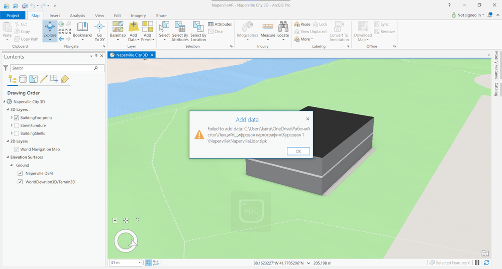

I am unable to add the NapervilleLidar.slpk file.

Hello, I am a student from Kazakhstan and I started to study ArcGIS Pro, and I really like this program, but I have a problem. And can you help about the lesson (Modeling a 3D city block). I am unable to add the NapervilleLidar.slpk file.Ошибки .png

try loading it from a simpler folder and one that isn't linked to onedrive  (eg c:\data

That goes for dropbox too. I've had issues with read/writing data directly from dropbox.

Make sure that you have downloaded the NapervilleLidar.slpk file to your local machine.
