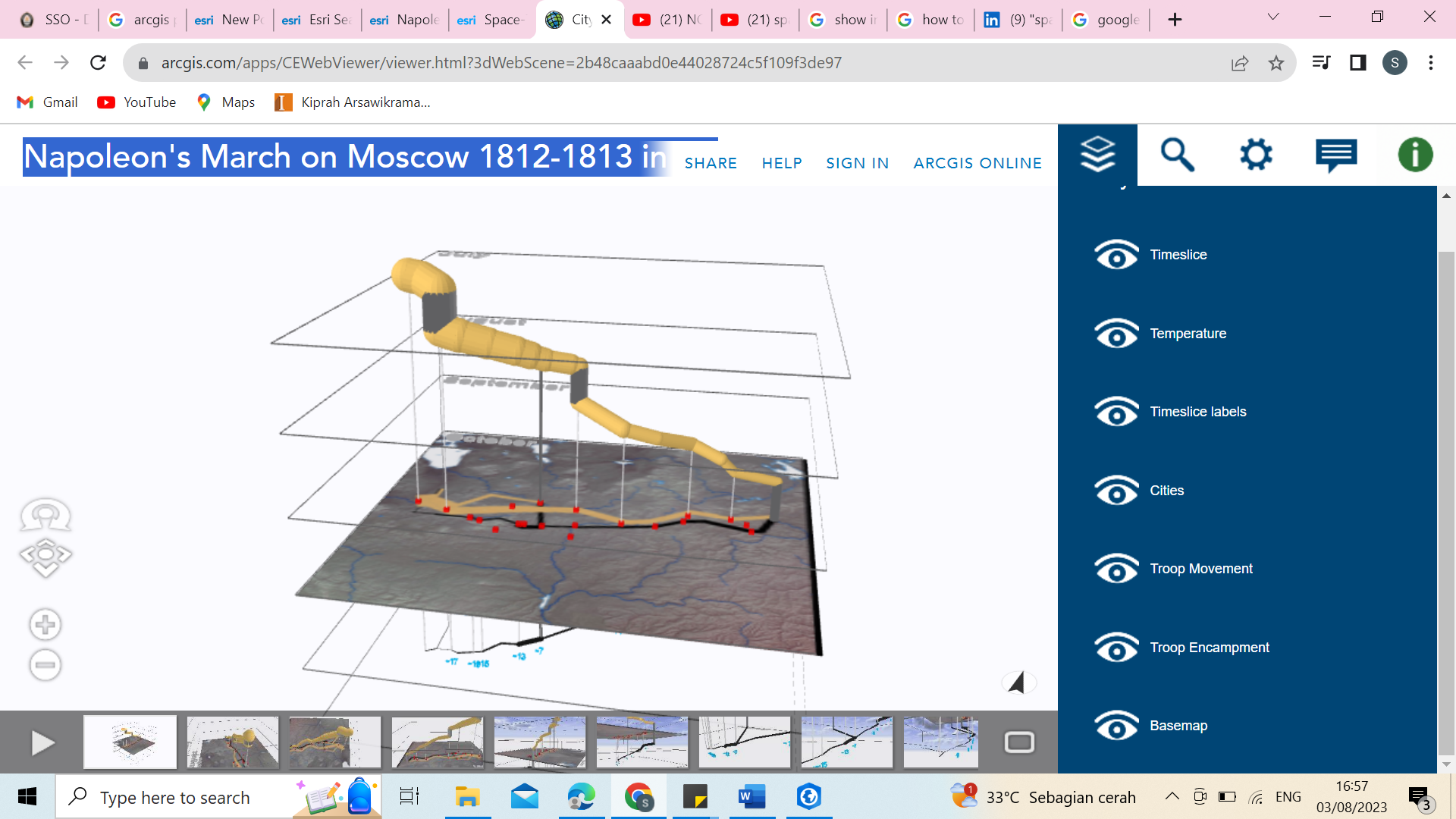

Hello, I have created space time cube for cultural heritage distribution in some area in my country. I really confused how to show the boundary line for each time layer, for example like this picture below.
In that screenshot, you can see the boundary line in each time period. I also want to create that kind of visualization in my space time cube result. What should I do with the boundary line? How to show those boundary in each period of time?

That specific web scene has been created in City Engine, not ArcGIS Pro. However, parts of the workflow have included ArcGIS Pro. Today, it might even be that you do not need City Engine at all, as Pro has evolved.
Have you seen this page where the workflow is described in general terms?

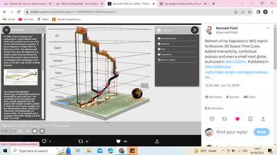

Hello again,, I still struggle to create time slices layer in space time cube using ArcGIS Pro. I found this upgraded model from the previous one that I uploaded before.
https://twitter.com/kennethfield/status/1138859944529186816
In that upgraded model, he used ArcGIS Pro. Do you know how to create the time slices layer in space time cube using ArcGIS Pro?
AndreasHall
You have to do it manually. Try creating a polygon "at the right height" and then use Duplicate Vertical to create a boundary line for each time period you want to be shown. Symbolize the polygons with a black border and no fill color.
