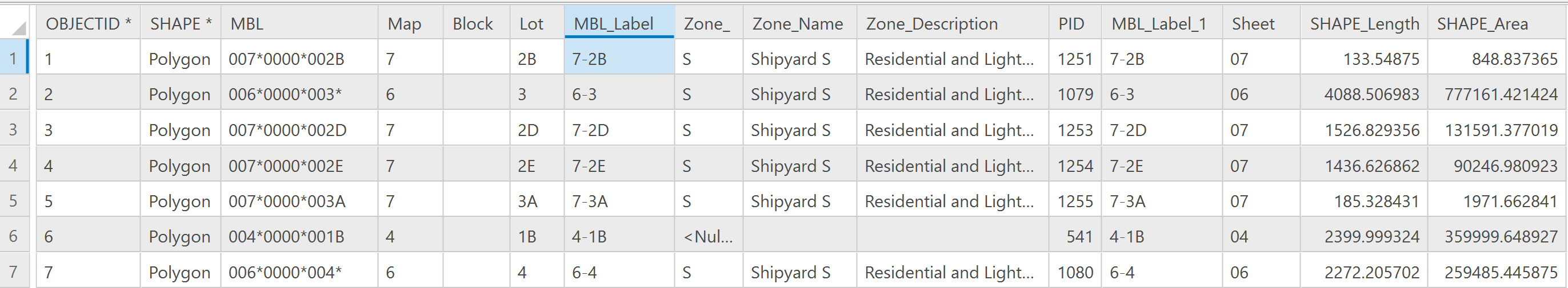

ArcPro 2.8.3.  Apologies if this is an easy problem, but I want to identify parcels in my city that have two street frontages (corner lots, typically).  I have a ParcelPolygons layer...

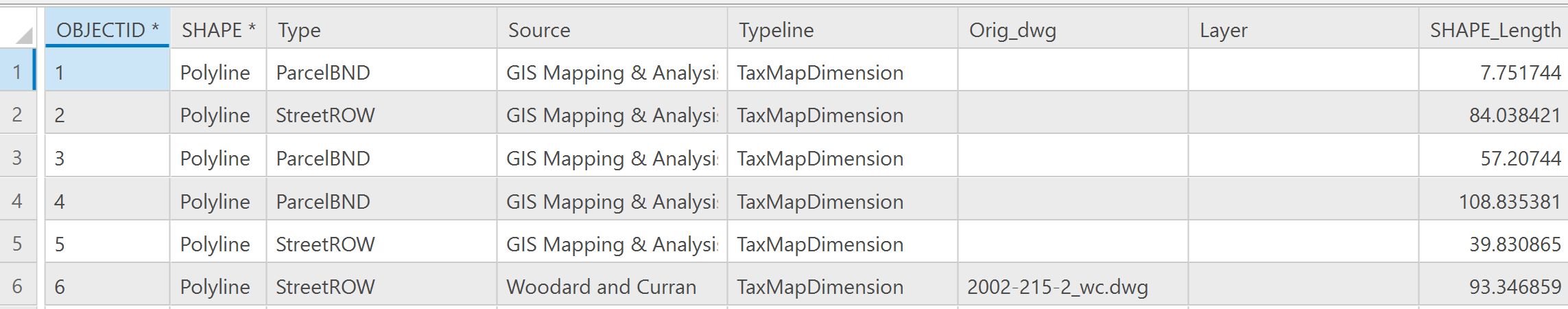

... and a ParcelLines layer:
Using Select by Attributes I created a new layer consisting of ParcelLines that are StreetROW lines, but I don't know where to go from there.  How do I choose ParcelPolygons that touch/intersect with two StreetROW lines?
