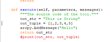

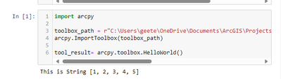

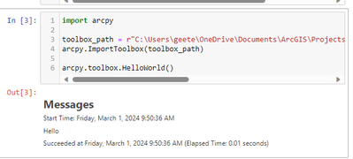

If you want to print, string/tuple or any other data type:
If you want to return arcpy.message, then, instead of 'print', use 'return':
    def execute(self, parameters, messages):
        """The source code of the tool."""
        out_str = "This is String"
        out_tuple = [1,2,3,4,5]
        arcpy.AddMessage("Hello")
        return
How did I debug?
Using return statement, python understands there is an output, but it returns empty.
I am not sure, if this is expected behavior or not, but this is how I run my code.
Best, Geetesh

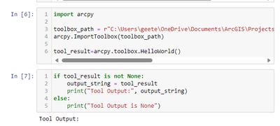

uasdev
HI @GeeteshSingh07 , this option does not work for me. The return value is None when I try to return variables within the execute function in arcgis tool.
