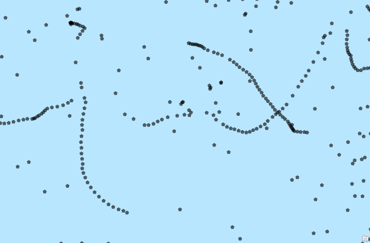

I have a bunch of data points, which are from Sea-Bird Monitoring.
I need to remove the data points of the sea birds drifting on the ocean to create a heat map for identifying foraging hot spots.
How can I remove the data points that are too close to each other?Screenshot 2023-09-24 172353.png

Manually:
  • Summarize Nearby, choosing your point layer for both input feature classes
  • Select and delete each feature in the output fc where point count > 1
  • Select points by location, intersect with the summarize fc, these are the points you want to keep.
Python:
points = "TestPoints"
min_dist = 50
# buffer the points and intersect the points with the buffers
# (this is basically what Summaize Nearby does)
buffers = arcpy.analysis.Buffer(points, "memory/buffers", min_dist)
intersects = arcpy.analysis.Intersect([points, buffers], "memory/intersects")
# count the occurence of each ORIG_FID (the point OID) in the intersections
orig_fids = [row[0] for row in arcpy.da.SearchCursor(intersects, ["ORIG_FID"])]
orig_fid_counts = {fid: len([fid1 for fid1 in orig_fids if fid1 == fid]) for fid in orig_fids}
# create a new field in the point layer that stores the count of nearby points
arcpy.management.AddField(points, "NearbyPoints", "LONG")
# calculate that field
with arcpy.da.UpdateCursor(points, ["OID@", "NearbyPoints"]) as cursor:
    for oid, np in cursor:
        try:
            np = orig_fid_counts[oid] - 1
            cursor.updateRow([oid, np])
        except KeyError:
            pass
This will create a new field in your point layer. You only want to include points where that field is 0 in the heatmap. Delete the others or exclude them through selection/definition query.
