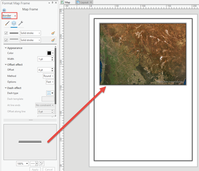

In Pro how would I get a layout to have a border? Not just the map frame but the whole layout (I want to be able to only insert the map frame in part of the layout).
Thanks!
10 Replies
LindsayRaabe_FPCWA
MVP Regular Contributor

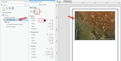

If you want the border to match your map frame, then best to use the map frame border symbology to get what you want (you can offset lines like in my below demo).
If you want it separate to your map frame, then a rectangle graphic is the simplest I can imagine.
