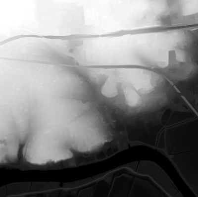

Each cell of low_slope is 5x5 meters. Each cell with Value 1 has a slope of < 10°.
DEM:
Output:
