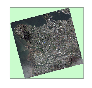

So far, I've created a working Python script (derived from another script meant to composite satellite imagery), which generates extent shapefiles of a satellite imagery raster based on min and max coordinates.  The biggest problem is that it assumes all rasters are oriented perfectly upright.  So it did what I asked it to do, but it's not actually the real extent, as my source rasters are angled.

Yeah, but if you have an angled raster (e.g. diamond shape), the lower left corner will not have a coincidence of xmin and ymin, etc.  You'll have a ymin, but the x value will be somewhere between the min and max extents of x.  Same with y...the upper right corner will have the ymax value, but the x value isn't necessarily at its max.
What I'm really wanting to do is create a polygon that shows the exact footprint of the raster, regardless of its orientation.  I guess I'm saying the word extents, but it's the footprint I'm after, if I'm using terminology correctly.

That can't be derived from the extent obviously, you will have to convert the nodata collar to a polygon, which you could get by classifying the nodata collar to 1 and everything else to 0.  Your probably multipart polygon would then have to be queried for each part's extent
A simpler solution would be to return the intersection points of the nodata and data collars

So I ended up creating a script using the Mosaic dataset footprint generation.  It creates extra intermediate steps but it isn't too bad--I just set a scratch workspace and delete the content later.
