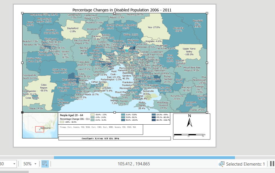

DengYijia
How to make three regions of this map highlighted or make the rest of the map monochromatic (i.e. black and white) ?
Robert_LeClair
Esri Esteemed Contributor
One very easy way to do this is via a Definition Query on your layer.  Add a new field to your feature class and for the polygons to highlight, calculate the new field to 1 or "Yes" or whatever term you want.  Then switch your selection and calculate the other polygons to NOT show on the map as 2 or "No" or whatever term you want.
Then in the Layer Properties->Definition Query, perform a definition query where NewField = "Yes" and click OK.  Only those polygons meeting the query show.  Add the same layer to the map again below the first layer, perform a query where NewField = "No" and click OK.  Only those polygons meeting the query show.  Symbolize those layers and a clear outline for example.  I'm sure there's other ways of accomplishing the same task but this is the first that popped to my mind.
