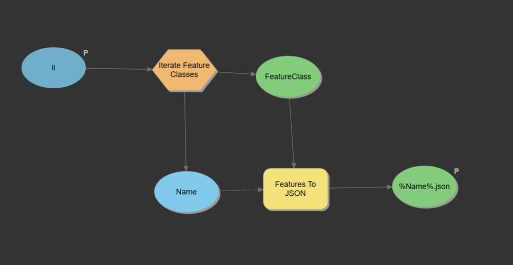

I'm trying to convert multiple shapefiles into geojson using an iterator.  However, Features to JSON tool does not allow you to specify an output name similar to the input features' name.
How is this done?

Never mind.  Figured out the solution:
In the Output Json: specify the folder location and for the name of the json file:  %Name%.json
ModelBuilder Features to JSONModelBuilder Features to JSON
