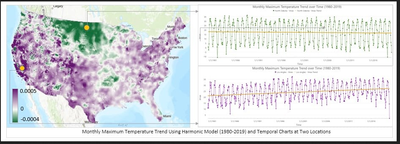

Good day,
I have used multidimensional temperature data (1980-2019) and the Generate Trend Raster tool to create a trend map below.
Is there anyway I can measure the statistical significance of the trends. What available tools can I use in ArcGIS Pro?
Many thanks

Generate Trend Raster (Image Analyst)—ArcGIS Pro | Documentation
Did you see the possible tests you can use in the help topic?
If the tool is used to perform either the Mann-Kendall or Seasonal-Kendall test, the output is a five-band raster as follows:
Band 1 = Sen's slope
Band 2 = p-value
Band 3 = Mann-Kendall score (S)
Band 4 = S Variance
Band 5 = Z-score
