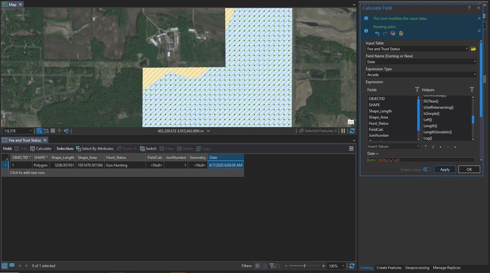

So I used Arcade for the Date calculation using Date(2020,5,7,0) on a Date/Time field and as seen in the attached file it calculated the field to be 6/7/2020 at 6 AM in this case.  The key is that the month field starts January as a zero and counts to 11 for December.
