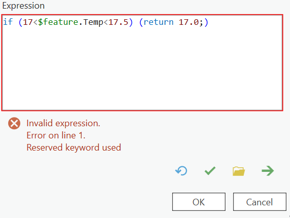

Hello! I have ArcGIS Pro version 3.2, I believe. I'm trying to plot temperature data as a color and then sensor type as a shape. Say, for example, I have 8 sensor types. There are two I care about and want to make a triangle, the rest are circles. I think I found a way to do that by using "Unique Value" in the Symbology pane, then just changing the ones I want to which shapes I want. Then I want color to vary by temperature.  I want to the "Vary symbology by attribute" pane to change color according to temperature. But then it makes the color look confusing, where it only labels the highest and lowest values, and the rest are just in the middle. I want to have the color bar range from 17-23 by 0.5 deg C intervals. Is there a way to do this? I tried in Arcade but got an error, so I may not know how to type in it. Also, just in general, is there any easier way to do this whole thing?
Screenshot for confusing color bar legend:
Screenshot of attempted Arcade code and error:
I would then go through and write code for it up until number 23, but I can't get past this first error. Thank you for any help!

Ok so the legend getting formatted this way kind of looks like expected behavior, at least when you check the "Show Legend" button in the Vary Symbology by Attribute pane. The next question is: what is the end result of the map you're making? There's a variety of ways to re-frame the issue you're having, but it would be helpful to know what you want the result to look like.
For example, you could just use the arcade you have now to set the available ranges, then change the symbols of the points to triangles:
Then if you only wanted some of the sensor types, you could use a definition query to only include the values you need:
When it comes to the legend, are you going to need to make a layout and print this? Will there be a lot of changes? You can manually build/edit a legend in the layout if you needed to.
