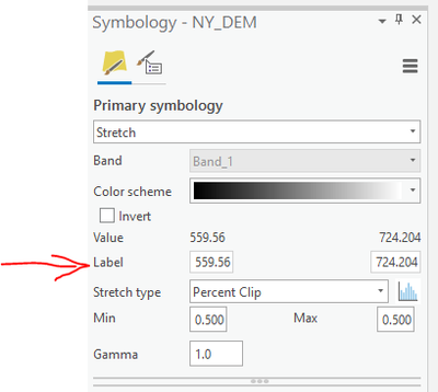

Right-click on the layer in the Contents pane and choose Symbology.  Then, in the Symbology pane, you can adjust the label.
