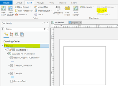

I am trying to add a measured grid in ArcGIS Pro 1.2.0. However, this option is not shown on the ribbon as we can see in the attached picture.

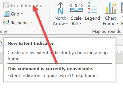

In Pro 2.6 you need at least 2 map frames on the layout.  If you only have one, then a bit of hovering should show some context sensitive help.  If you are really using version 1.2, you would be advised to upgrade because a lot has changed

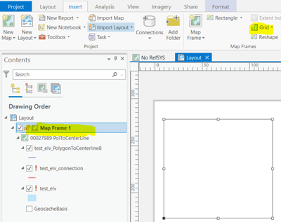

For the missing "Grid" it is hard to tell from your screenshot. In the layout you need to activate a Map Frame in the Contents Pane for the Grid command to be active. ie
Not active
Active
