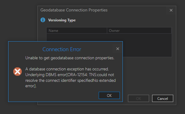

Using ArcGIS Pro 2.1.1 with Oracle 12.1.0.2, I get the following error when I try to look at the GeoDatabase Connection Properties:
The connection works fine and I can do just about anything else with the GDB.  The TNS as not an issue so it appears that it is an invalid error message...

I am testing Pro 2.3 Beta (Early Adopter program) and this connection error does not occur so it looks like this bug has been fixed, but we'll see in final release of Pro 2.3.
KoryKramer
Esri Community Moderator
It is fixed in Pro 2.3
