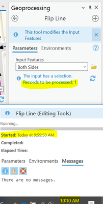

I upgraded to ArcPro 3.1.0 just a few weeks ago. I attempted to use the flip line tool on a single selection and I also see that the tool is Running... for much longer than usual and it doesn't seem to complete. Any update on this? I'm in the same situation - updating geometry of a feature class in a versioned gdb. I have seen a bit of weird behaviour with this feature class recently i.e. edits are committed as soon as I update a feature and I cannot choose to save or discard the changes. In the meantime, I've been using the replace feature geometry tool to make the changes but it is very tedious.
