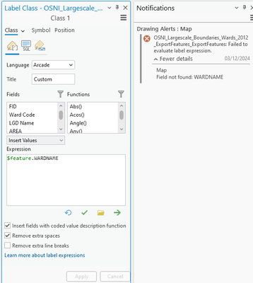

BEN12345
Please see below screenshot of the expression. When I use the Export Features geoprocessing tool to create a new feature class it brings up that warning message that it failed to evaluate label expression no idea why this is?
Robert_LeClair
Esri Esteemed Contributor
This is very strange as my ArcGIS Pro UI is identical to the Label Class pane and I do not get such an error message.  Something to try - when I see strange application issues such as this, I recommend a soft reset of the ArcGIS Pro application.  The steps to do so are here.  Another thing to try is create a brand new ArcGIS Pro project file and attempt your workflow again.  Sometimes project files (*.aprx's) get corrupted.
I'm using ArcGIS Pro 3.4 - what release of Pro are you using?
