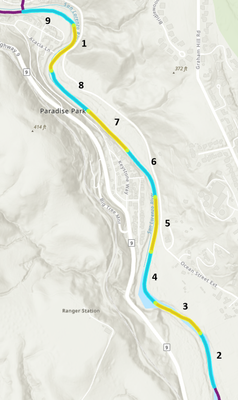

In Pro 3.4.2, I'm using the Divide tool to split a stream line into 9 equal parts. Pretty basic.
The processing preview looks fine....
But the new reaches, sorted by ObjectID, are out of order. Rather than the first reach being the downstream-most, it's second from the upstream-most.

@JMutunga Thank you for the reply. This is in a much larger context than just splitting a single line -- I was trying to keep the question short, but maybe I kept it too short.
I have a sample frame of 50+ streams, and each stream needs to be split x times (in this instance, 9). This results in hundreds of line segments, each of which needs to be numbered recursively, downstream to upstream (in the same order as the larger streams that are being split). The sequential calculations I have are based on the ObjectID, where it does indeed matter in which order they are spit out.
