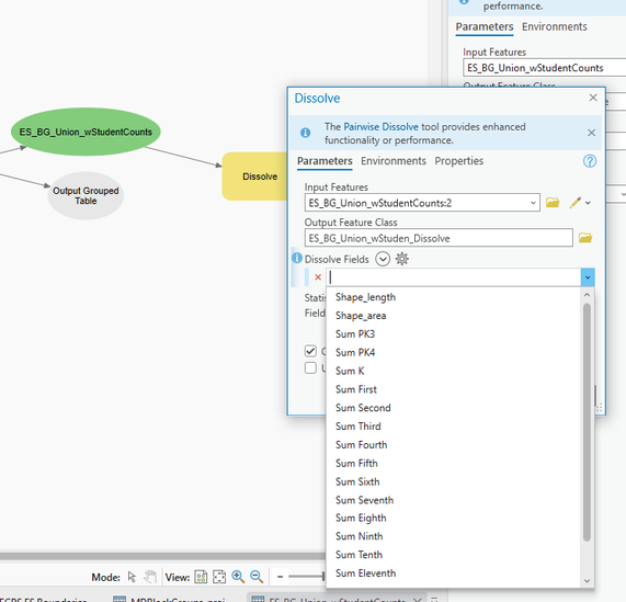

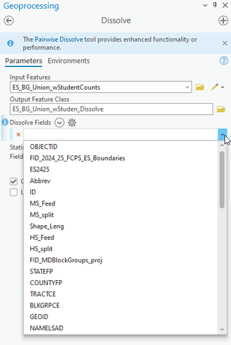

AmberMillison
Actually to follow up in case anyone else is having the same issue, when I access the Dissolve tool directly from the toolbox, the text fields show up. When I add it into my model and use the same input features, it's only showing numeric fields. Very odd but at least I know it is possible.
Model:
Geoprocessing toolbox:
