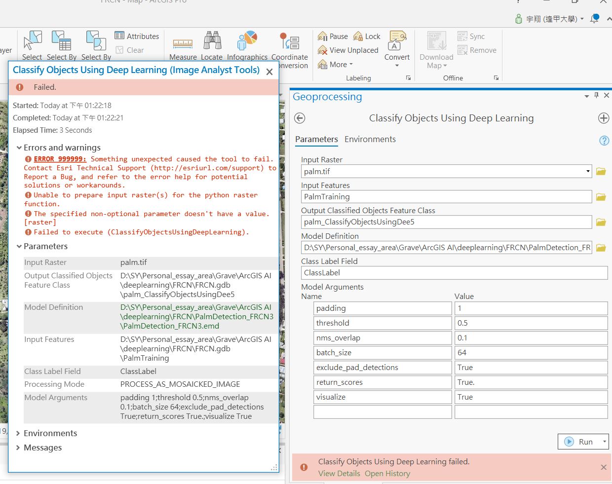

Hello. I am a newbie about deep learning and I was trying to run the "Detect Objects Using Deep Learning" tool to detect palms in a tiff aerial image an I got an error (see below). I'm using ArcGis Pro 2.7.

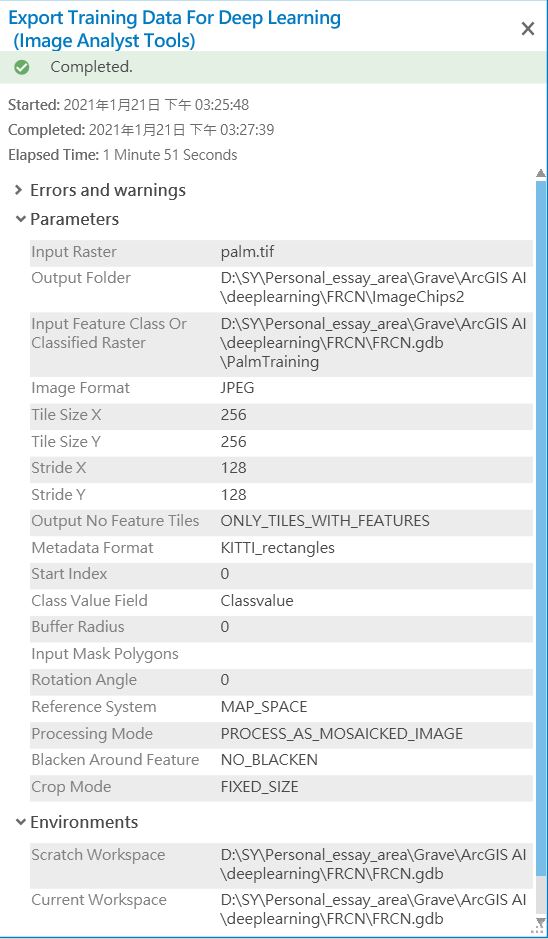

I followed the workflow successfully, meaning that I created the labeled objects, trained the model - no errors at these stages. When I tried to run the "Detect Objects Using Deep Learning" tool I got the following error message:
"ERROR 999999: Something unexpected caused the tool to fail. Contact Esri Technical Support (http://esriurl.com/support) to Report a Bug, and refer to the error help for potential solutions or workarounds.
Unable to prepare input raster(s) for the python raster function.
The specified non-optional parameter doesn't have a value. [rasters]
Failed to execute (DetectObjectsUsingDeepLearning)."

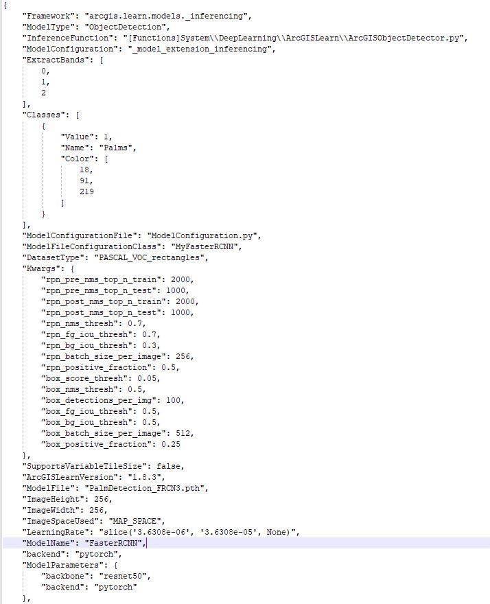

In order to export the training data of Faster RCNN, I used the metadata format: KITTI_rectangles, but the problem as I mentioned was not able to run the last tool (detecting objects)

HI,
I see you have trained an object detection model, you need to use the tool "Detect Objects Using Deep Learning". Let us know if you still face any issue with that.

TAN860421
That's right, this tool should be used in the correct way, thank you.
