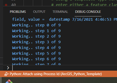

I found the docs on using Visual Studio and PyCharm but I wonder if anyone has had success with Visual Studio Code?
I set up launch.json and I can attach to ArcGISPro.exe but I am not sure what comes after that. I can set breakpoints in my .py file from the IDE but they are never hit.
I use F5 to run and wait for the status bar to go orange which indicates it's running. I must be very close, because I can see print() statement output in the IDE's Debug Console window.
I am running ArcGIS Pro 2.8 on Windows 10 using the newest VS Code.
