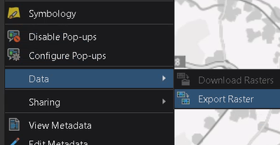

So you have georeferenced maps of your pond from different years and want to extract only the area around the pond?
You can do it this way:
  • scroll to your pond
  • for each of your georeferenced raster:
    • right click on the layer in the contents
    • Data -> Export Raster
    • In the Export Raster dialog, set the Clipping Geometry to "Current Display Extent"
Have a great day!
